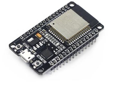

- Any ESP32 board, for easier demonstration I will use ttgo-t-display-1-14-inch-lcd-esp32-control-board

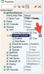

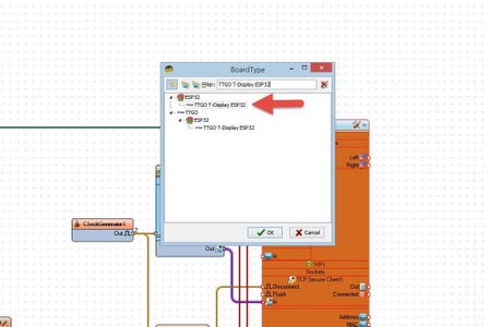

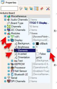

Start Visuino as shown in the first picture Click on the "Tools" button on the Arduino component (Picture 1) in Visuino When the dialog appears, select your ESP32 board in this example we will use "TTGO T-Display ESP32" as shown on Picture 2

- Select TTGO T-Display ESP32 board and in the properties window expand "Modules>WiFi>Connect To Access Points
- Click on the Connect To Access Points 3 Dots button

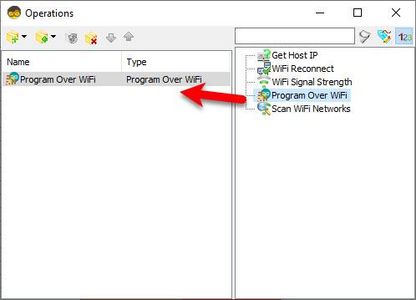

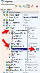

- Select TTGO T-Display ESP32 board and in the properties window expand "Modules>WiFi>Operations
- Click on the Operations 3 Dots
- In the Operations window drag "Program Over WiFi" to the left side
- In the properties window set Hostname for this example I will set it to "Test1"
- In the properties window Optionally set the Password (password that you would need when accessing (Programming Over The Air )
- Close the Operations window

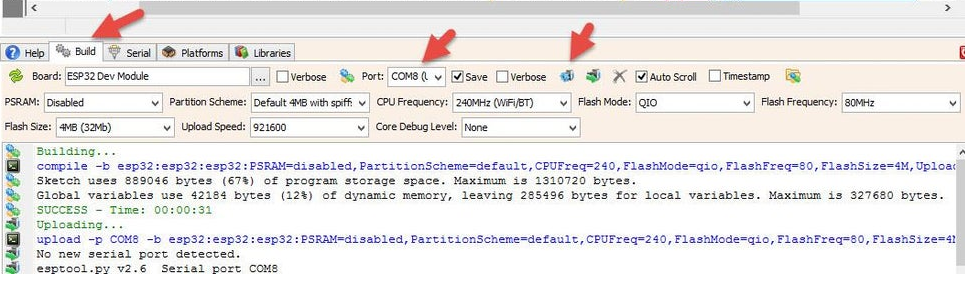

For the first time you need to connect the ESP32 board to your USB port.
In Visuino, at the bottom click on the "Build" Tab, make sure the correct port is selected, then click on the "Compile/Build and Upload" button.

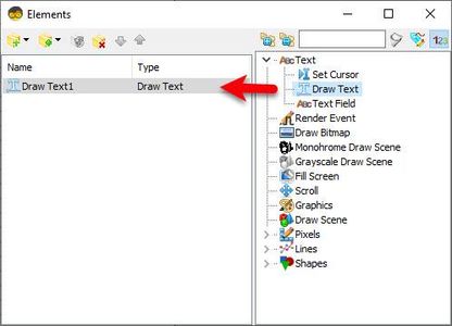

- Select TTGO T-Display ESP32 board and in the properties window expand "Modules>Display>Elements" Click on the Elements 3 Dots
- In the Elements window Drag "Draw Text" to the left and in the properties window set "text" to TEST

After Uploading the IP will appear in the PORT window, select the IP ,then click on the "Compile/Build and Upload" button.

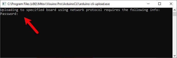

A window will open requesting a password. If you did not set any password in the Operation window then just hit Enter button. and Visuino will start uploading the Project Over the WiFi.
Note: Sometimes a windows Firewall or Antivirus programs can block the connection, preventing the upload. In that case pause the firewall or add an exception to it.
