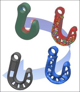

Step 1: Understand the Basics of Topology Optimization
Topology optimization is a type of structural optimization which aims to optimize both shape and size of a body according to a given load, while staying within specific restrictions, i.e. keep 30% of material while maximizing stiffness. The objective is to maximize stiffness, while a constraint is to retain 30% of the material.
  1. Crash course in the 3 types of structural optimization: size, shape, and topology optimization.
  2. In size optimization, the final shape is known but size of shape is unknown, and the objective is to determine the shape; for example, you know the length and position of a cantilever but not the cross-sectional thickness
  3. in shape optimization, the final size is known but shape (aka form, contour) is unknown, and objective is to determine size.
  4. topology optimization basically combines both size and shape optimization. the initial design (3d model) is given, a load is specified, and constraint(s), and topology optimization is used to find the optimal design according to the specified conditions. In this context, a load is a place where force acts on your system, such as a table subjected to a load of 100 N.
  5. There's multiple methods for topology optimization, which all work to solve the generalized topology optimization problem (see section 2 "General design problem"):
  6. Density (Bendsøe 1989; Zhou and Rozvany 1991; Mlejnek 1992)
  7. SIMP (Bendsøe and Kikuchi 1988; Rozvany and Zhou 1992)
  8. Level-set (Allaire et al. 2002, 2004; Wang et al. 2003)
  9. Topological derivative (Sokołowski and Zochowski 1999)
  10. Phase field (Bourdin and Chambolle 2003)
  11. Evolutionary approaches (Xie and Steven 1993)
  12. just to name a few
  13. Ansys offers level-set, SIMP, and lattice optimization methods
