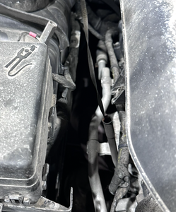

Step 2: The Engine Bay
Now that your vehicle is jacked up you should pop the hood and locate the Oil Fill Cap and the Oil Dipstick. Once located take the cap off and put it somewhere safe. Lift the oil dipstick out but not all the way. Now would also be a good time to check other fluids like your coolant level, And windsheild washer fluid. Now would also be a good time to fill your window washer fluid with washer fluid.

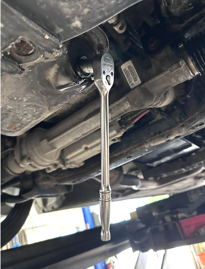

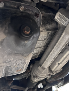

Step 3: Under the Car
First you need to locate your Oil drain bolt. Now losen your oil drain bolt. Now get ready for the fun step 4.

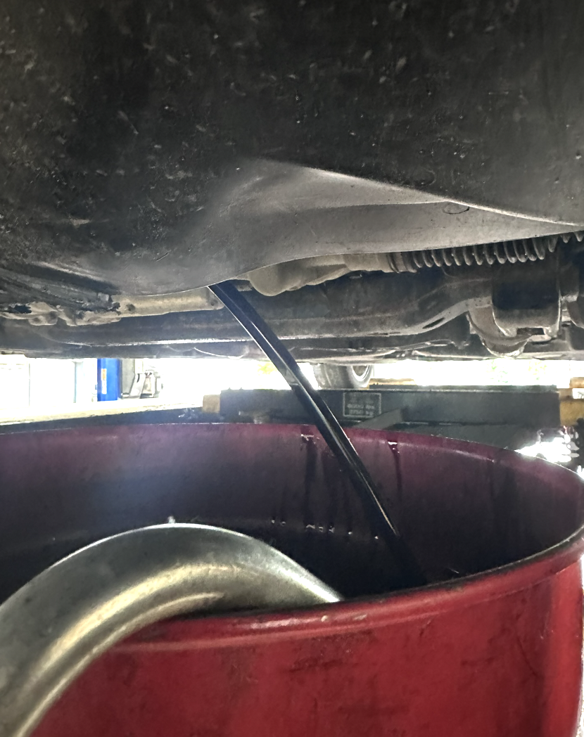

Step 4: Let It Flow
Now that its losen you need to unscrew it with your hands the rest of the way. Once it is out the oil will come out fast immediately. You are gonna wanna catch the oil in your drain pan.
Step 5: Tightener Up
Now your gonna wanna tighten your oil drain bolt up but be VERY CAREFUL here. If you over tighten it you can risk breaking it and stripping the oil drain bolt hole. A good feel to make sure it is tight it when you have to apply a semi big amount of pressure.
