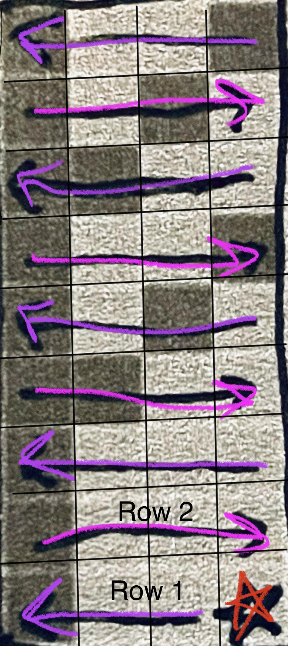

Step 4: How to Read the Pattern
- Start at the bottom right corner. (The red star.)
- Each square represents 1 pair of K/P stitches.
- Read from Right to Left on odd rows.
- Read from Left to Right on even rows.
- Don’t think of the squares as specific colors, but instead of as an “on/off” switch.
- The marked squares symbolize which K/P pairs are “on” or “off” for that row.
- (They will have the opposite color on the other side of the fabric.)

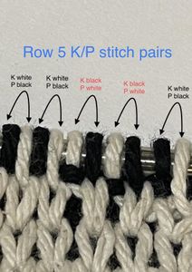

Row 5) Following the pattern, continue to knit the knits and purl the opposite purls, bringing both colors of yarn over the needle after each stitch. When you come to a marked square on the pattern, knit that knit stitch with the opposite color of itself. Then purl the following purl stitch with *it’s* opposite color. Both the knit stitch and the purl stitch make up that *one* marked square.
In the example, I’ve knitted a white knit stitch with black yarn followed by purling a black purl stitch with white yarn.
<==BWBWWBBWBW==|
Remember, all the knit stitches are knitted and all the purls are purled. The alternate color in the pattern simply signals a flip in yarn colors.
Row 6) Do the same thing as Row 5, except with the colors switched. On the printed pattern, you will go one row up and this time start at the left most square and work to the right. (The blue star.)
