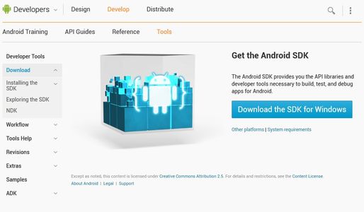

Step 1: Step One
In your browser, navigate to the following link: http://developer.android.com/sdk/index.html.
Click on the "Download the SDK for [Your Operating System]".
If the operating system displayed by the button does not match your operating system, click the "Other Platforms" link directly below the button, and select the correct operating system.

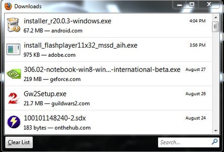

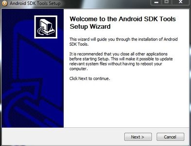

Step 2: Step Two
After the download completes, click to open the file and follow the steps provided by the installer.
Step 3: Step Three
The installer will first specify if you have the Java SE Development Kit installed.
After that, you will need to specify which users to install the Android SDK for, and then select the install directory.

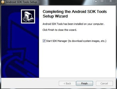

Step 4: Step Four
In the last step of the installation process, make sure that you select "Start SDK Manager."

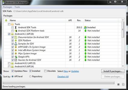

Step 5: Step Five
A new window should appear titled "Android SDK Manager."
Choose the packages which you would like to install.
The following packages are required:
SDK Tools
SDK Platform-tools
SDK Platform
Other recommended packages include:
System Image
Android Support
SDK Samples
After selecting the packages you want to install click "Install [x] packages..."

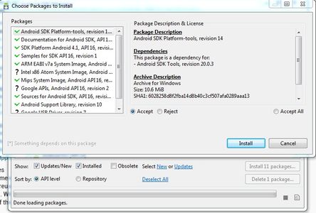

Step 6: Step Six
You will then be directed to a new window to confirm which packages you would like to install.
If everything appears correctly, click "Install."
