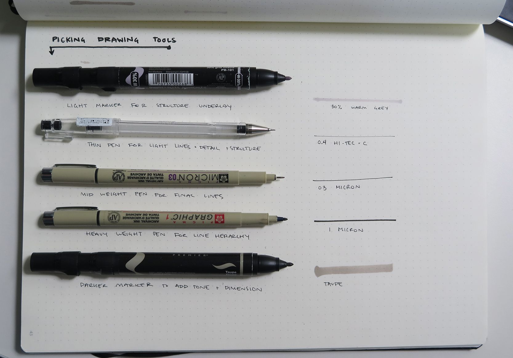

Step 1: Picking Tools
Selecting the right drawing tools is important. The types of tools you use effect the outcome of your drawing. Different pens, markers, and pencils can be used to create different marks. Keeping a variety of mark making tools on hand while drawing can help you build hierarchy into your drawing. Hierarchy is important for emphasizing relevant information, creating dimension, and allowing structure lines to recede into the background.
There is no "right" set of tools and everyone prefers something a bit different. But there are some more popular tools that you might consider exploring.
Here's some of the pens and markers I've been using recently.
I've been drawing for a while so I'm comfortable with stiffer mediums like fine weight pens. If you're new to sketching I would suggest starting in a looser more forgiving medium like colored pencils, prisma sticks or markers.
You should not use (unless otherwise specified):
- Ruler
- Eraser (never erase or throw away old sketches!)
Here's a link to more drawing tools you might want to check out:

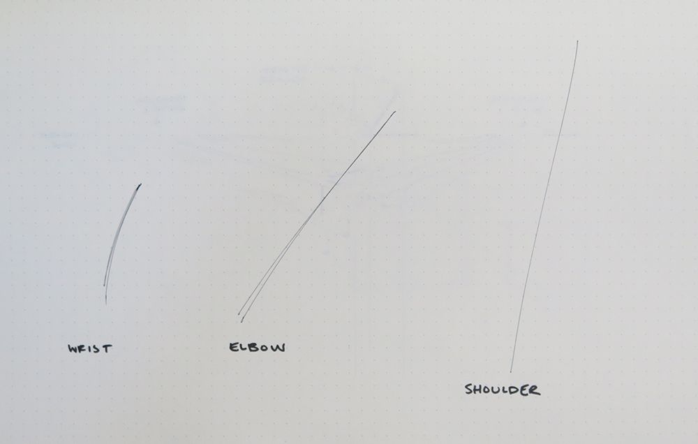

Consider motions and muscles you use while drawing. Drawing is not confined to just the hand. Drawing uses your whole arm.
Drawing from your shoulder allows you to create more accurate lines because it has the largest range of motion. Always draw from your shoulder!
The wrist has the smallest range of motion and thus is more likely to create arc rather than straight lines. Drawing from the elbow has a slightly larger range of motion but is also likely to create arcs.
Some people find drawing towards yourself rather than away is also more likely to create straight lines.
