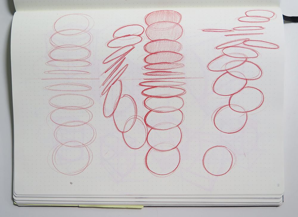

Here's some cylinders drawn using major and minor axis.
You might also want to play around with moving ellipses around in space to get yourself familiar with how they behave.
Notice how they become more and more circular the higher or lower they are in relation to the horizon line.
