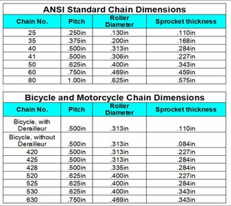

Step 2: Determine Your Key Dimensions
I will be demoing 40 tooth #40 chain, which has a Pitch of .5in and a roller diameter of .313in.

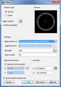

Step 4: Use Circular Pattern to Finish the Sprocket
Once the first tooth is drawn and the reference geometry is removed (1), finishing the gear is a simple two step process of first using the circular pattern tool to pattern the tooth around the start point per the number of teeth. Then simply draw the needed center whole size about the start point and delete the start point plus any leftover reference geometry.
Note: for previous AutoCAD users you will likely find the "Fill Angle and Total Number of Elements" setting in DraftSight to be the best way to create the circular pattern.
