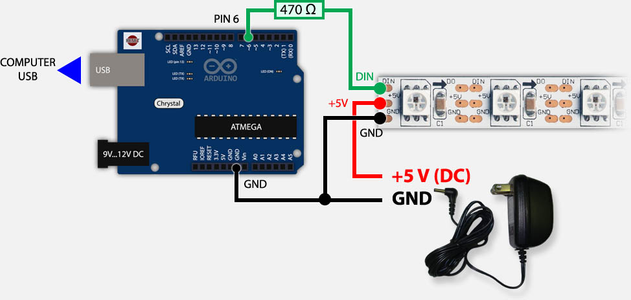

Step 1: Connection
Connect the 4-7VDC pin of the WS2812 light strip to the 5V pin of the Arduino Uno.
Connect the GND pin of the WS2812 light strip to the GND pin of the Arduino Uno.
Connect the DI (data input) pin of the WS2812 light strip to the digital 6 pin of the Arduino Uno.
