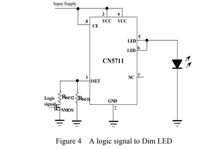

There are 3 modes of operation for this IC:
  1. With a PWM signal directly applied to the CE pin, the frequency of the PWM signal should be less than 2KHz
  2. With a logic signal applied to the gate of an NMOS (Figure 4)
  3. With a potentiometer (Figure 5)
Using the PWM signal it is very easy to drive the IC with a microcontroller like Arduino, Esp32 and AtTiny85.

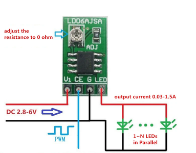

Step 2: Drive the Led With the Built in Potentiometer
I hope the wiring is clear in the photos and video.
V1  >> blue  >> power supply +
CE >> blue >> power supply +
G >> gray >> ground
LED >> brown >> led +
To power the circuit I used a cheap power supply (made with an old atx power supply and a ZK-4KX buck boost converter). I set the voltage to 4.2v to simulate a single cell lithium battery.
As we can see from the video, the circuit powers from 30mA to more than 200mA
Step 3: Drive the Led With a Microcontroller
To control the circuit with a microcontroller just connect the CE pin to the PWM pin of the microcontroller.
CE >> purple >> pwm pin
G >> gray >> ground
Setting the duty cycle to 0 (0%) the LED will turn off. Setting the duty cycle to 255 (100%) the LED will light up at maximum power. With a few lines of code we can adjust the brightness of the LED.
