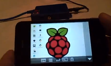

Connect a TV to the RCA output; connect a keyboard and mouse to one Pi USB port; connect the other Pi USB port to the EggBot's micro USB port; insert the Pi SD card; connect 5VDC Pi power source.
Step 10: Install the Inkscape and EggBot Software
Install Inkscape with the terminal command "sudo apt-get install inkscape" (The Pi will need to be connected to your network via Ethernet for downloads). Install the EggBot extensions from EMSL.
Step 11: Use the Raspberry Pi-hacked EggBot
With your Pi-powered EggBot connected to keyboard, mouse, and TV (but no external computer), decorate your eggs using the EggBot Inkscape extensions.
