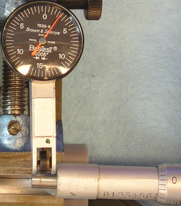

Start with how the spindle moves. Is it pretty much free-moving, but with a solid feel, not a loose feel? Does the spindle assemble wiggle, either axially or side to side? Are there tight or loose spots?
If the answer to any of these questions is not satisfactory, walk away. The pictures show the axial and side to side play in the GL micrometer, and it isn't a particularly bad example. The play is quite easy to feel. The axial play is a bit less than 1/1000", and the side to side play is about 2/1000, though these numbers vary with spindle position and where the assembly is wiggled.
Even though the tool makes measurements in the axial direction, the side to side is a bigger issue, since, in use, the threads always register to the same side axially, but the side to side play allows the measuring faces to come out of parallel and changes where on the thread face the spindle meets the threads in the frame.

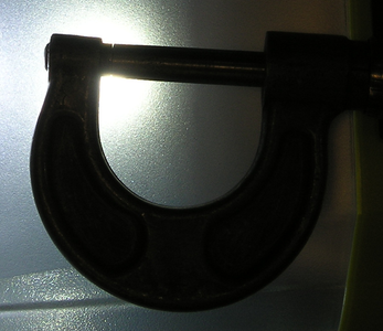

But then comes the first problem, and it is a deal breaker. The measuring faces don't align. When the spindle comes out, there is no adjustment for wear, we look down the bore and see that the bore really doesn't align with the anvil. It is easier to see if the anvil is properly flat and smooth, so the surface is like a mirror, but it is pretty visible here.
How does this happen? It can be from a number of things, among them dropping the tool, trying to use it as a clamp, or even poor manufacture. I have no idea how it happened with this one.
How will this tool perform in the real world? A test of the axial and the side to side play tell us that it isn't a good tool to begin with, as there is 2.5/1000" axial play, and 5/1000" side to side, at the position tested. This is enough to be felt easily, and can even be felt wearing gloves. I doubt it was this bad when it left the factory, as Central Tool produced (and still produces) good quality under their own label and for other labels, but this one isn't even pretty enough to hang up for the holidays.

The spindle threads are accurate, and the movement, in this example, is fairly smooth. The problems show when we look at how the anvil and spindle meet. On The reading is zero, but there is light visible between the faces. Neither face is flat. This tool can not ever be accurate.

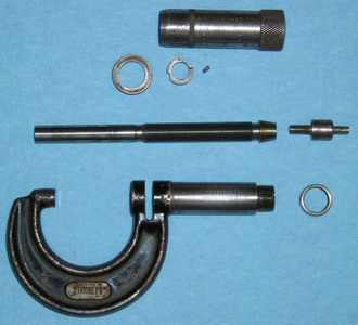

This is a micrometer that cost a dollar. It looked rough. There was rust. It didn't move. For all practical purpose, it belonged in a skip on the way to be turned into a Toyota.
But, I took a shot (full story in my bestselling saga "Evaluate, Repair and Adjust a Second-Hand Micrometer", also available from this fine publisher).
The things that differentiate this tool from the ones we have looked at include: The adjustment ring at the end of the spindle bore to take up wear by slightly squeezing the end of the threads; the tool can be fully disassembled in a straightforward manner (removing screws); the zero adjustment is well designed (it can be adjusted while the tool reads zero and not done by moving a working part); the frame is made of a high quality, stable metal (a high grade cast iron); the faces, though not perfect and with a small ding, are still mirrorlike.
There are few top quality that miss more than one of these points.
Despite the initial condition, how did it fare when tested? When adjusted, it passed basic calibration tests. When checked for play (which is the easiest thing to feel when buying), none can be felt. The measurements are 3/10000" (0.3/1000") axial, and less than that side to side at the point tested. This is just enough for the light oil film that lubricates the spindle threads and helps protect from rust. In fact, to show the axial play took more force than any of the other micrometers, and several seconds for the position to settle as oil moved through the clearance in the threads.
This is a quality tool and quite usable as it is to 1/1000", though it will get the faces lapped back to perfection at some point.
