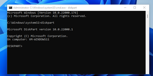

Step 1: Open CMD on Windows PC
Press Windows + R keys and search for CMD. press enter and open the command prompt.
Step 2: Run Diskpart Command

Step 3: Vie the Available Disks
Type the commandlist disk and press enter.

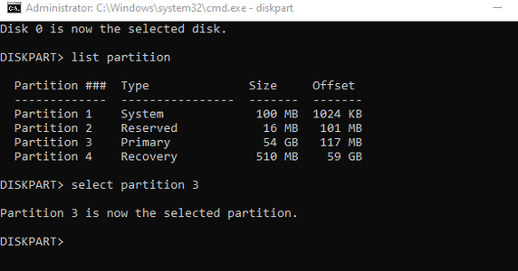

Step 4: Select the Disk You Want to Extend
Type select disk 0 and press enter.
0 is the number of your system disk. Replace it with your Disk letter
Step 5: View the Partitions Available on the Drive
Type the commandlist partition and press enter.
Step 6: View and Select the Desired Drive Partition
Type the command select partition 3.
replace the number 3 with your disk partition number
Step 7: Extend the C Drive Partition
type extend
type exit.
The diskpart will extend the partition and exit the tool.
