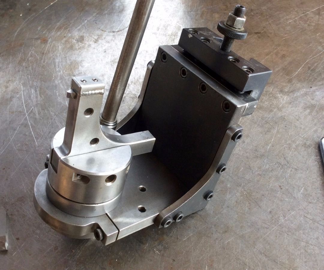

I was recently drilling/tapping blind holes in 1/8" aluminum plate. Yeah, I know. I was tapping for 2-56 screws, which are just a tiny bit larger than 1/16" in diameter. I needed to about 12 holes and of course... I broke the tap. On the last hole. I had a lot of machining time invested in this small part, and I was on a deadline. I decided to try a trick I had learned years early from my sensei. I had never used the trick before on something so small, but what could I lose?
