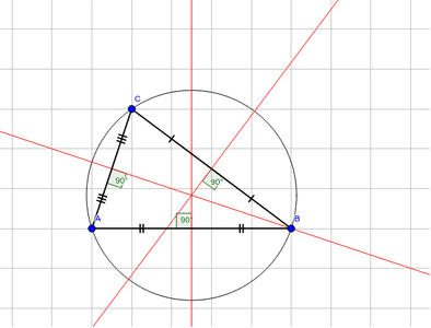

In this method, we will use GeoGebra (or equivalent software) to draw a model of the situation. Then we will use it to find the circumscribed circle of the triangle and ultimately measure the radius. This could also be done on paper, but for good accuracy, software needs to be used.
Step 3: Build the Initial Situation
Build the initial situation in a geometry software such as GeoGebra using your own measurements for width and height. This should just look like a T, with the chord and height with given lengths. Us a segment and perpendicular bisector to do so.
Step 4: Create the Triangle
Create a triangle using the extremity points of the T.
Step 5: Perpendicular Bisectors
Create a perpendicular bisector in each of the triangle's edges.
Step 6: Intersection and Circumscribed Circle
Use the intersect feature to create a point at the intersection of the 3 points (really 2 but they all meet at one point).
Create a center circle at using this point of intersection. It should pass through the 3 points of the triangle.
Step 7: Measuring the Radius and Angle
Measure the radius of the circle by creating a segment between the center and one of the chord's extremity points.
With width = 1.3m and height = 2.15m, it gives 1.173 as the radius of the circle.
For the angle of the sector that the chord is in, just create another segment and measure the angle. GeoGebra gives us 67.289°.
