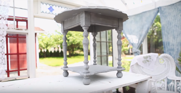

Step 1: Paint Your Piece
Tough Coat can be applied to almost any water-based surface, but it’s generally used to seal in the finish of our paint.
It is very important to make sure that you let your last coat of paint dry for at least 24 hours before proceeding with Tough Coat, otherwise you may end up with a streaky finish.

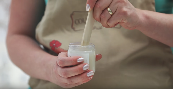

Step 2: Stir the Tough Coat
Tough Coat should never be shaken. If you do shake it, you can incorporate bubbles which may appear on the finish of your piece. We recommend stirring the contents of your jar for about two minutes, an occasionally during application if you’re working on a large piece. You don’t want important ingredients to settle at the bottom!

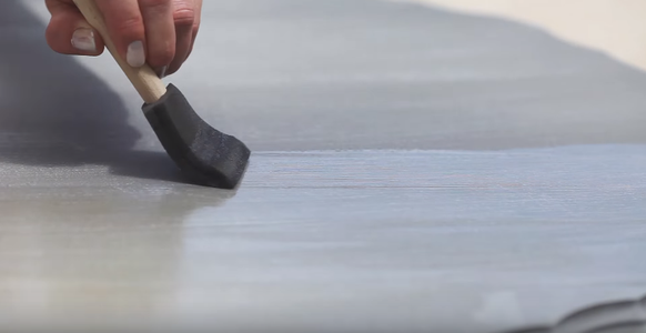

Step 3: Apply Tough Coat

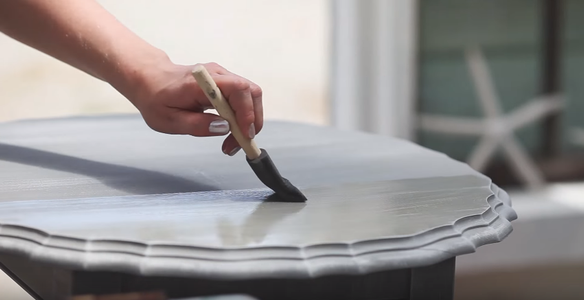

Using a foam brush, apply Tough Coat in long, smooth strokes in one direction. Tough Coat dries quite quickly, so you’ll want to keep a wet edge and avoid going over the same area twice. If you see a patch you’ve missed, resist the urge to go back and fix it. It’s better to wait until the first coat is fully dry before you do touch ups or you can add texture to the finish.
It is best if the temperature that you are working in doesn’t exceed 70F or 20C. If you find that it dries too quickly, you can thin Tough Coat with up to 5% water.
Please note: NO wax should ever be used underneath Tough Coat.
Step 4: Add a Second Coat
We recommend using two coats of Tough Coat for optimal protection. Your second coat can be apply after approximately 2 hours.
