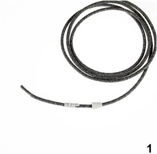

Step 1:
Take one end of the cable and insert, in the order, the components A and B.

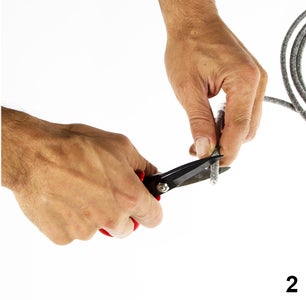

Step 2:
Unsheathing the cable taking care of not to damage the cables.
Step 3:
Strip the cables being careful not to damage the copper contained within.

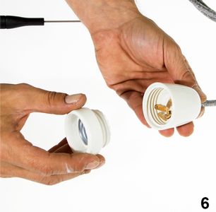

Step 4:
With the aid of a screwdriver pressing the copper lug that rests on the inner groove, separating C from D.
Step 5:
Pass the cable into the fissure closer to C and insert the end of the two cables inside the terminals of the element E and tighten until full fixation
Step 6:
Insert E within C and secure the socket screwing D to C

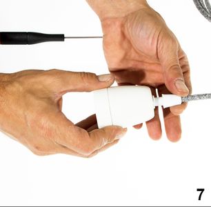

Step 7:
Secure the cable to the socket screwing B to C, then A and B

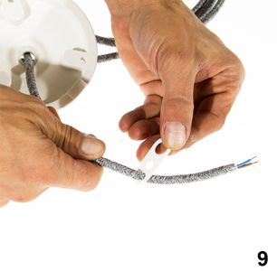

Step 9:
Insert cable within G and passing through the fissure tighter.

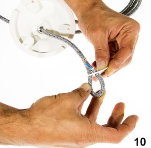

Step 10:
Once decided the length of the cable from the wall, bend the cable by passing by the center hole. The remaining hole can be used to further secure the cable to the wall with a hook (not supplied).
