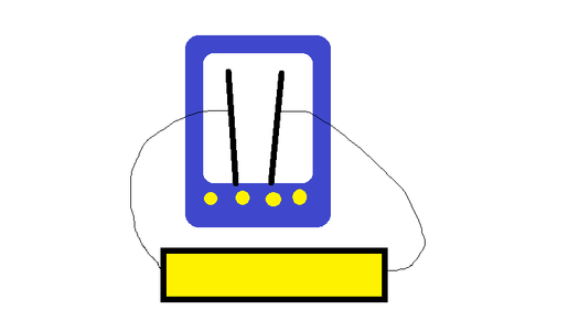

Laptop Charger or PSU (Set PSU to 18 or 19v)
Thin Wire (You can get these wires from ethernet cable) See Image.
Crocodile Clip. See image
Solution
1. Check Pinouts of Battery.
2. Usually pinouts for positive negative are mentioned on battery, if not search on google pinouts for your battery model.
3. Take thin two thin wires about 7 inches.
4. Let Wire 'A' positive and Wire 'B' negative.
5. Remove 1cm cover from wire A from both sides.
6. Remove 1cm cover from one side from wire B, and remove 2cm from other side, fix the second side in crocodile pin.
7. Insert wire A in positive slot of battery. Insert 1 cm of Wire B in negative slot.
8. Insert other end of Wire A in hole inside charger pin (postive slot of charger), and attach outer conductor (negative slot of charger) with crocodile clip.
9. Leave battery for 2 hours.
