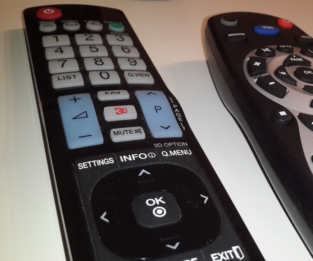

Note: The remote controls we have bought from e-commerce sites were lacking the most crucial function: on screen pointer. Therefore I highly recommend you to fix your original unit.

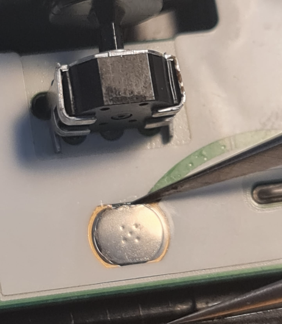

Step 2: Fixing the Non-Working Button

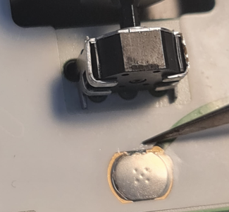

The buttons are covered with plastic coating therefore to clean the contacts, we need to scrape off the coating just a few milimeters first. You can do this with the tip of the tweezers or a needle.
After scraping off the coat you can spray some isopropyl alcohol on the button, letting the alcohol to diffuse into the switch and click a couple of times allowing the friction to do the cleaning.
I would highly suggest to also spray some alcohol on the scroll mechanism while turning the wheel. This will also clean the scrolling mechanism and won't disappoint you at least a couple of years.
Wait until the alcohol fully evaporates.
