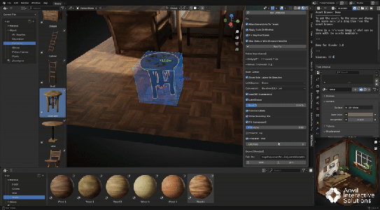

Step 6: See the Truth: AABB Vs OBB + On-Mesh Labels
  1. AABB (Axis-Aligned Bounding Box): quick, world-aligned bounds.
  2. OBB (Oriented Bounding Box): “true” extents aligned to the object’s local axes—best for rotated meshes.
  3. Place labels inside the box and set precision.
  4. Use standard colors (X red, Y green, Z blue).
  5. “Draw On Top” helps in dense scenes.
With USD: Toggle Use OBB, Fill Alpha, On Top, Label Precision, Colorize Labels.
