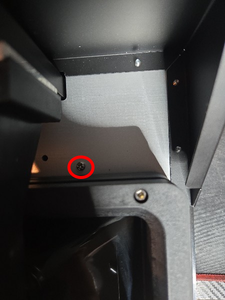

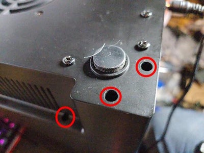

Before you start, make sure there is no resin in the reservoir. Remove these six Phillips Pan Head Self Tapping Screw. Remember to keep your screws separated. It will make putting everything back together easier.

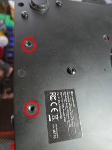

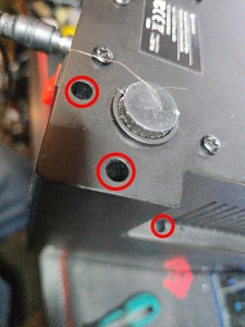

Next turn the printer upside down and remove these six pan head machine screws.

Remove these two final screws and carefully lift the base off. Be careful the WIFI module is glued to the aluminum frame and the main control board and WIFI antenna are attached to the base.

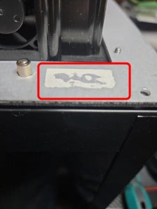

Next detach the WIFI module from the aluminum frame. I used a small pairing knife to do this. Be careful, there is not much room to work. I was not able to take a picture of before I removed the WIFI module. I used the double sided tape to stick the WIFI module to the bottom of the base not far from the fan.
