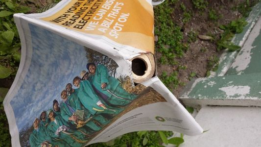

Cover the buddha with a few sheets of old newspaper and cut a hole in the top where the opening is.
Prepare a new batch of cement mix. Carefully pour the mix into the opening, wait for it to harden a little and level the cement flush with the rim of the neck.
You now have to work fast. Carefully remove the newspaper with the excess cement, then quickly move on to the next step.
