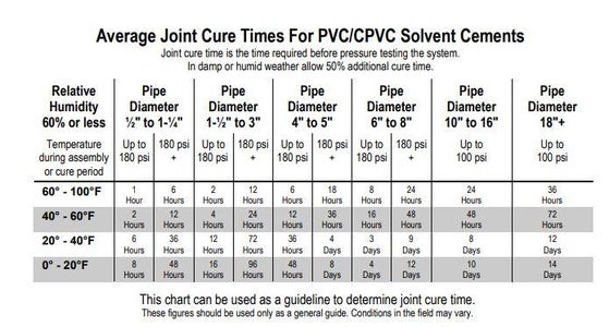

Step 6: Let the Joint Cure and Dry
Now let the joints cure and dry. Follow this chart to determine how long.
Step 7: Test for Leaks
After waiting for the time on the chart in the previous step, turn the water back on, slowly. as soon as the water is on, inspect the joints to make sure there are no leaks.
