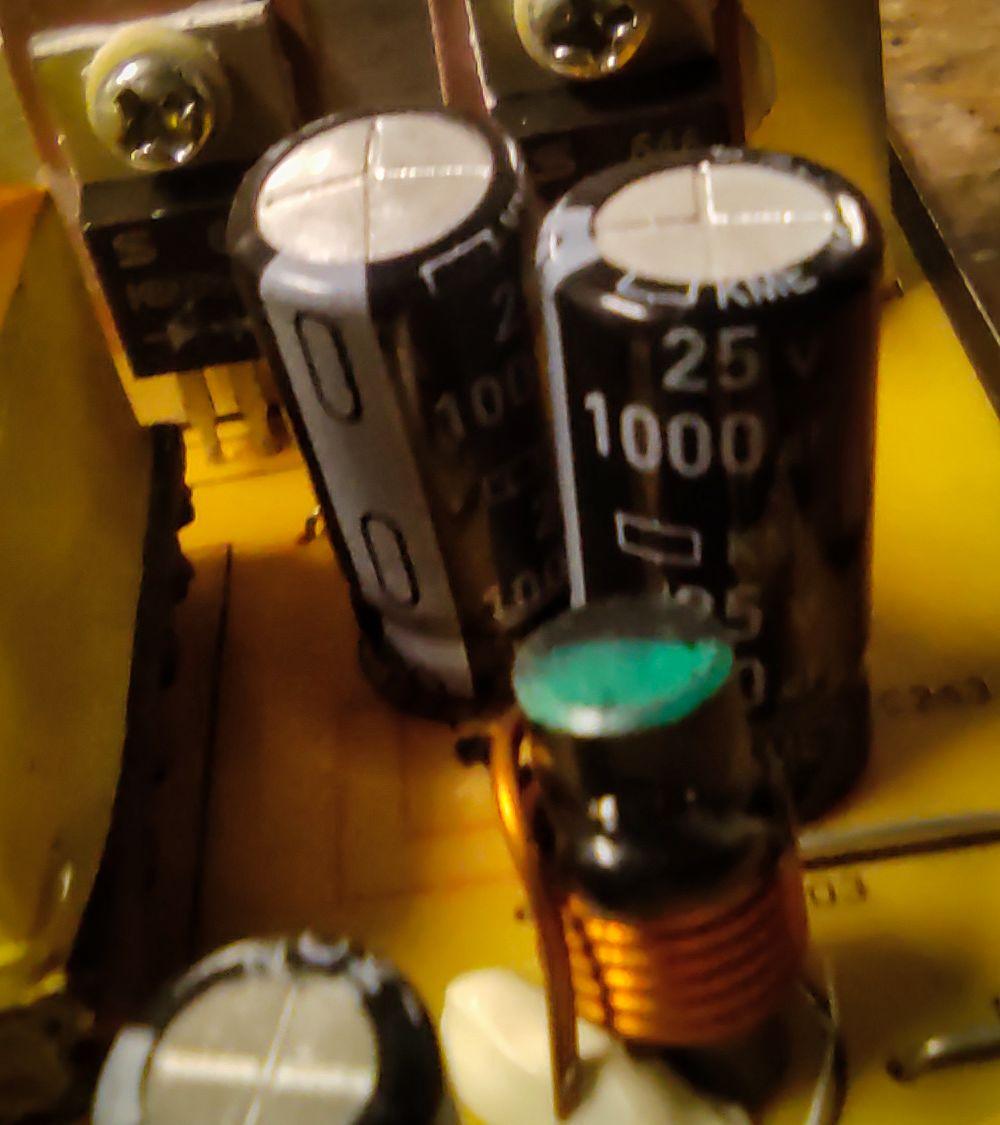

Step 3: Locating Bad Caps
The next step now that you have the PC boards isolated, is to figure out which capacitors, or "caps" for short are the likely culprit.

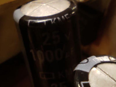

Luckily, it's usually easy to diagnose and can be discernable with the naked eye due to "bulging" capacitors.
These bulges are created when the capacitor is subjected to voltage/current outside of it's range. It usually doesn't happen in newer devices, but over time the electrolyte in the capacitor breaks down and it's operating range changes. Too much time and the standard variables for the monitor will be outside of the capacitor's range and it fails, causing a bulge.
*Note; this is off the top of my head + a quick google search to verify. If this explanation is wrong, please correct me and I'll edit it.
Once you've identified the culprit, look for it's values on the side of the capacitor. In particular, we're looking for Voltage (V) and Capacitance (uF).
For the bulging capacitor in this example, it wound up being "25V 1000uF".
Since they're fairly cheap, I decided to replace ALL of the aluminum "can" type capacitors on this board with the assumption that the others are probably not very far behind the already bulging one on their way to failure.
*Note: There were none of this type of capacitor on the green board, so I decided to just leave that one alone.
