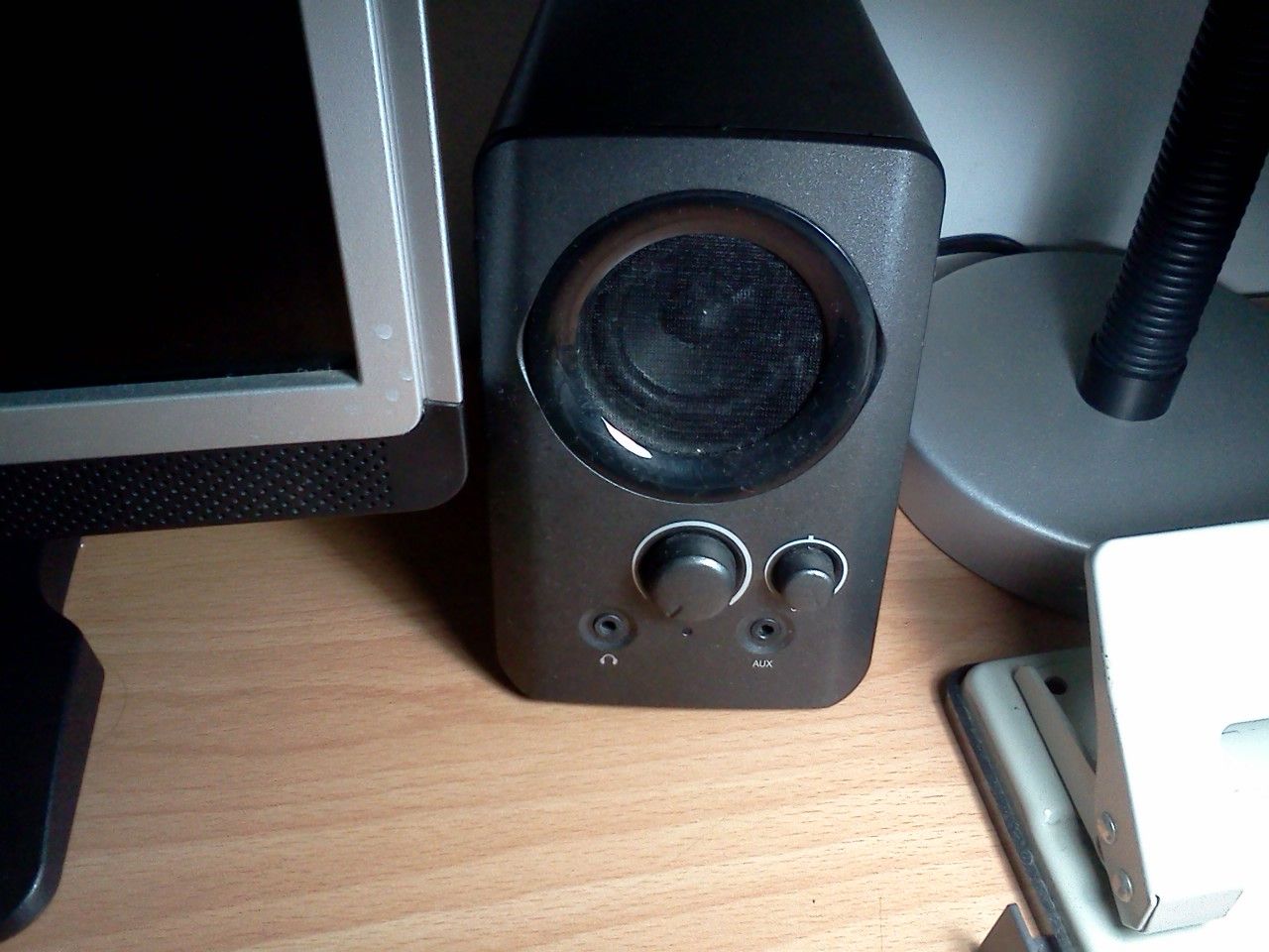

In this instructable, I will detail how to fix a speaker with a broken potentiometer or knob. Clear sings of a broken potentiometer are a speaker or a bass that does not work properly normally; yet when you push or move the knob, springs back to life.
In my case, the speakers were Maxell's Mblast 2.1 speakers, although the process is virtually the same for all speakers. The bass control knob, the upper one in the picture, is the broken one.
To make my terminology clear, the decorative knob refers to the plastic knob you hold, the potentiometer refers to the electronic component underneath that is malfunctioning.
