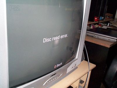

Introduction: How to Fix the PS2 "Disk Read Error"
If you have ever owned a Play Station 2 (thick version) you may have had deal with the "Disk Read Error" problem. At first it is not so bad, just one or two of the games don't work, but after a while almost none of the games work. You can pay money to send it in to Sony HQ and have them fix it or you can just do what they do by yourself for free.
