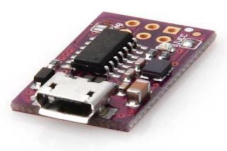

- ATtiny44 USBTinyISP Programmer

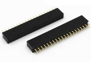

- Double row 2.54 mm Pitch Straight Needle Female Pin Header

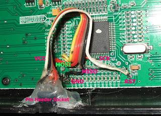

Step 2: Hardware Installation

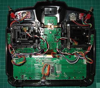

- Open TH9X transmitter case off by screwdriver.

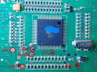

- Solder Double row pin header socket with Dupont wires and the marked soldering pad on TH9X PCB mainboard together(see pictures).
- Cut a hole on transmitter case for header socket.
- Fix pin header socket with transmitter case by hot glue gun.

- Download ATtiny44 USBTinyISP Programmer driver from
http://fab.cba.mit.edu/content/projects/fabisp/ select usbtinyisp w32 driver v1.12 for windows 32bit.
- Click installer_x86.exe to start installing.(This installer could not run on 64bit operating system)
- Connect ATtiny44 USBTinyISP programmer to the pin header socket that we have prepared with PC's usb port.If the operating system select FabISP driver instead of usbtiny driver.You have to change it in device manager property.

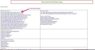

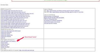

- Download eePe-EEPROM Editor from http://www.er9x.com/
- Install eePe-EEPROM Editor on your computer.
- Download er9x standard firmware.Save er9x.hex file to hard drive.

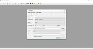

- Open eePe-EEPROM Editor
Select Preferences menu,setting parameter as shown in the picture.
Profile of your transmitter can be changed as your transmitter mode/stick setting.
Programmer parameter has to set "usbtiny" and mcu has to set "m128".
- Open Read Firmware from Tx in Burn menu,save your original firmware to specified directory.
- Open Flash Firmware to Tx in Burn menu,browse your download directory and select er9x.hex file to be flashed to.Click ok.Wait until flashing process complete.
