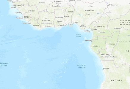

When you add a file which has not been georeferenced, you will be prompted to build pyramids and calculate statistics. These are optional in most cases and will take additional time to complete if you choose to do them. You will then receive a notification saying "Unknown Coordinate System". This means that the file has no information attached to it yet saying where it should be projected. As a result, the default location at 0,0 latitude and longitude off the coast of Africa will be used until you specify otherwise. To see the image at its current location, you can right click on it in the contents panel and select "Zoom To Layer". Once you are ready to begin georeferencing, pan and zoom the map to the location which your imagery should be located.
