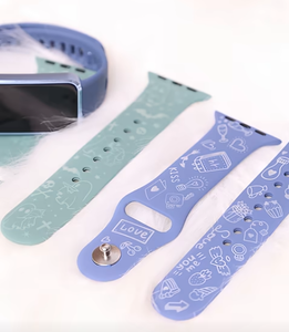

Laser marking on personalized watch straps transforms everyday accessories into bold statements of style and individuality. By adding intricate and precise designs, laser marking brings out the unique character of each strap—making every piece truly one of a kind.
Looking for a standout gift that reflects personality and creativity? These custom straps combine durability with striking design, perfect for expressing yourself every day or elevating any outfit with a touch of personal edge.

Once laser marking is complete, carefully open the door and get your personalized liquid silicone rubber watch strap!
laser marking watch strap show
