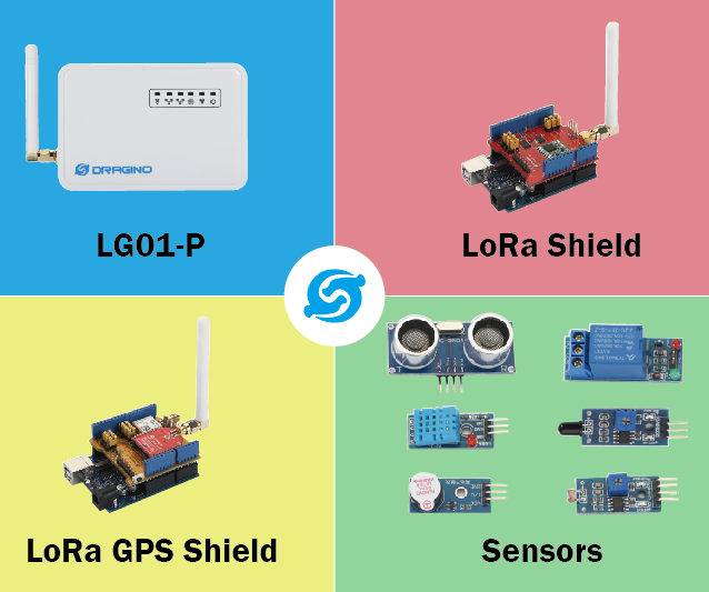

Introduction: How to Get Sensor Data From a Remote Arduino Via Wireless Lora Protocol
This is an example to show how to get sensor data from a remote Arduino via Wireless Lora Protocol.
The exampels requries below hardwares:
1) Client Side: Arduino + Lora Shield (868Mhz) + DS18B20 (Temperature Sensor).
2) Server Side: Arduino + Lora Shield (868Mhz) + Yun Shield + USB flash.
make sure the USB flash has this file datalog.csv in the data directory of root.
Requrie below software: Radiohead library from: http://www.airspayce.com/mikem/arduino/RadioHead/...
Client side will get the temperature and keep sending out to the server via Lora wireless. Server side will listin on the Lora wireless frequency, once it get the data from Client side, it will turn on the LED and log the sensor data to a USB flash.
Follow the next operations to complete this project.
Step 1: Preparations
In this project,you need the things below:
  • Arduino board x 2 (We use the MEGA2560 here)
  • Dragino Lora Shield v1.3 x 2 (We use 868MHZ here)
  • Yun Shield v1.1.6 x 1
  • USB flash x 1
  • DS18B20 x 1 (Temperature sensor)
  • Bread board x 1
  • 868MHZ antenna x 2
  • USB cable x 2
  • LED x 2
  • 4.7k resistance x 1
  • Some jump wires
  • Power supply
Note:
About the Yun Shiled,we must use the Yun Shield v1.1.6/Yun Shield v2.2.4 or higher version
