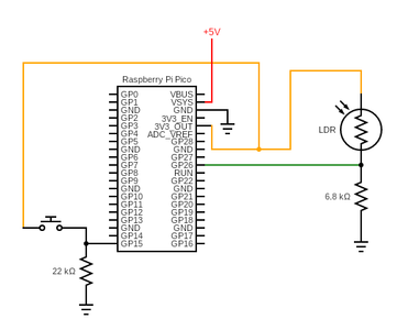

Components:-
  • Raspberry pi pico.
  • Button switch.
  • Resistors 6.8K and 22K.
  • LDR (or any sensor of your choice. I am using LDR just for demo.)
  • USB cable.
If you are using Rpi pico for the first time. I recommend you to watch "Getting started with Rpi pico."
Step 1: Make the Circuit.
Make the connections as per the circuit diagram if you want to use LDR as a sensor. +5V DC is provided between VSYS pin and GND pin of Rpi pico through USB cable. For now the board is connected to the computer because we want to see sensor data and print status on the shell / console. Rpi pico operates on 3.3V but we don't need a 3.3V regulator cause Rpi pico has a in-buit buck boost converter that converts input voltages (1.8V - 5.5V) to 3.3V. The circuit operating voltage is also kept at 3.3V because the ADC reads 3.3V as maximum value.

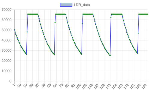

Step 3: Getting Graph Using Quickchart API.
API stands for "Application Program Interface". It's the link between your program and website or any web based application. The website will give you data in response if you requested providing proper parameters and auth key.
Quickchart is a open source web service that generates all types of graphs like line graph, bar graph, pie diagram, etc. All we need to do is post a request with quickchart's endpoint URL and our data enclosed in a JSON object. If our post is successful then we get the chart's URL in response. The chart generated by quickcharts free version are public domain, meaning you are free to use them for any purpose. To know more read quickchart's documentation .
Click on the below given URL to see how generated chart looks like. It's a bar graph.
https://quickchart.io/chart?c={type:'bar',data:{la...
In the above URL, "https://quickchart.io/chart" is API endpoint and everything after "?" is parameters. parameter "c" holds our chart data (for eg- Type of chart, X axis data, Y axis data, etc) as JSON object. JSON objects are easy to read and write using JSON module which creates ".json" files.
The best thing is that, json module/package is available in python 3.10 as well as in micropython. Let's now see how to create ".json" file (that has our sensor data) using Rpi pico.
Step 4: Creating JSON File in Micropython.
JSON stand for "Java Script Object Notation". It is common format to send data across the internet or from one application to another. It has a format similar to a python dictionary. The data is enclosed in curly braces like this {data}". If there are many categories then data maybe a "key:value" pair. The value can either be a list or a dictionary. It may look confusing but it's good for programmers as they can easily dig through and get the desired data. It's good for computers but not for humans who are used to seeing data in form of tables, graphs and diagrams.
The above image shows quickcharts json object. Let's take a look at that and see where can we put our sensor data. The "chart_data" is a dictionary between two curly braces there are many "key":"value" pairs like "backgroundColor": "white", "width": 800. These parameters have fix value. All we need to change is the "data" key's value, that value consists of two lists namely "labels" and "datasets". "labels" is X-axis data therefore it will contain list of sample count [1,2,3,4,....max sample count]. The data corresponding to each sample is our sensor data or Y-axis data.
"datasets" list is a list of dictionaries and currently has only one dictionary because right now we are dealing with only one Y-axis parameter, We have only one sensor. In that dictionary there is "data" key and it's value is a list and that list is our Y-axis data.
Now that we have figured out were to put our sensor data. Let's create two lists, one will contain the sensor data and the other will contain the sample count.
Once we have the two lists we can create a function that creates ".json" file and that two lists which contain the X-axis and Y-axis data can be passed as arguments. This function will be called in the end after the sensor data and sample count are aquired in form of two separate lists.
".json" file will be created in the same directory/folder as that of the program file "main.py". The program file is provided below as "main_prog.txt"
*note - The program will print status "json file created" and will stop. To take new samples the program has to run again. There are some limitations to the max samples due to two reasons which will be discussed at the end of this blog.

  • Run main.py. If request is successful then we get the chart URL printed in the console.
  • Click on the URL and view your data presented wonderfully on a graph.
  • You can now download the chart image as ".png" file.
