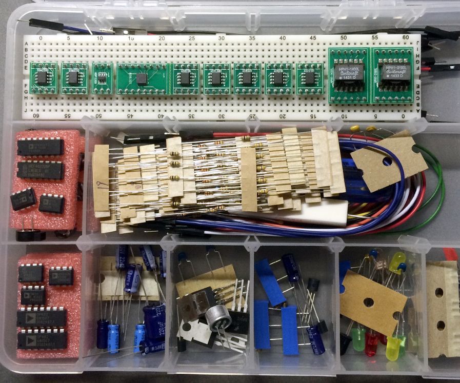

You will also need some kind of I2C parts, usually on a breakout board.
You can either go to a website like Sparkfun, Adafruit, or even ebay and search for parts on breakout boards.
Or you can “roll-your-own” so to speak. We are running a Kickstarter that happens to be for breakout boards and parts you solder on them. That campaign has ended, but if you are still interested then send us an email. You can contact us through Instructables, Kickstarter, or our website www.jouletime.com. Check out the Kickstarter here.
