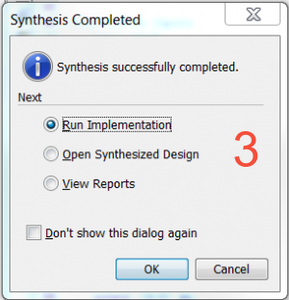

3. Run the synthesis (Image 2)
You will be asked like this, choose Run Implementation then Ok (Image 3)
The synthesized result will looked like this (Image 4)

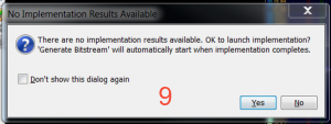

Then it showed that we have no implementation yet, just press yes (Image 9)

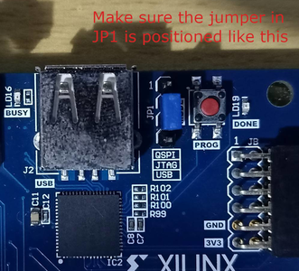

Note: Before we start, make sure to set the jumper mode on the JP1 pins to QSPI that looks like first image

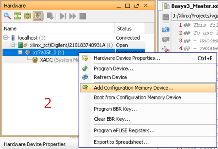

Step 1: In the Hardware Manager window (either through Image 1 or can be founded on Flow > Hardware Manager), under hardware right click your device and click Add Configuration Memory Device (Image 2)

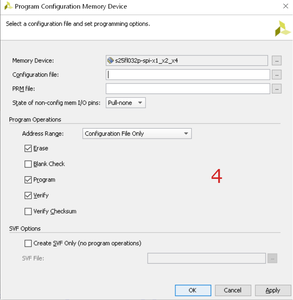

Step 3: Select the .bin file where it asks for a configuration file and finally click Ok. (Image 4)
Vivado will now erase the old configuration file, and reprogram your Basys3 with the demo file. From now on, when you power up the Basys3, the demo will load at startup until you reprogram it.

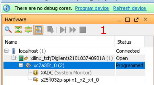

Step 1: First, make sure that the jumper JP1 is in the JTAG position and that the Basys 3 is plugged into your computer via micro-USB cord. Once the board is plugged in you should see something like image 1.

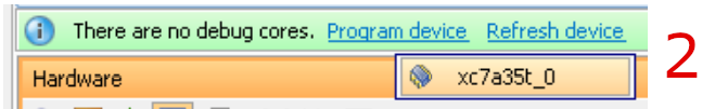

Step 2: Click “Program device” (in the green bar, image 2) then xc7a35t_0, select your .bit file in the bitstream file box, and click Program (Image 3).
This will program your Basys 3 board through the JTAG connector. Once the programming window is closed go ahead and test out your board. Each slide switch at the bottom of your board should now toggle its respective LED on and off.
