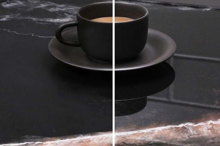

Please note: the natural surface finish when using a coating resin is a super glossy, glass like finish.
To achieve a matt finish simply follow steps 1-5 in the next section of this Instructable, or to attain a satin finish follow both the matt finish and satin finish instructional steps.
Step 2: Matt Finish
To achieve a sophisticated matt finish on your countertop or other resin surface follow these simple steps:
  1. Abrade the surface using 1500 grit abrasive paper
  2. If you have access to a DA Sander this will make the process much faster although you can do it by hand
  3. If using a DA Sander, keep it moving to avoid overheating areas and only apply light pressure
  4. Clean and wipe the surface and inspect to make sure the shine has been completely removed
  5. Take care on rolled edges to avoid breaking through the surface and visually check to ensure no glossy spots remain, giving it a final clean
You will now have a contemporary matt finish on your countertop or other project!
