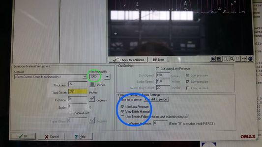

Whoever created the materials database for Omax waterjets didn't consider the lucrative process of adding value to bricks, another example of short sightedness in the human race. But we were not deterred and proceeded to cut some holes in bricks using existing settings like Nevada Shale and Wyoming Limestone the former cut went well but took a very long time and the latter didn't make it all the way though in most spots. We eventually settled on a custom stone setting of 3500 machinability. We also discovered if a cut was going to start very near an edge having the "Very Brittle Material" and "Low Pressure" pierce settings prevented cracking, but for all the internal cuts we turned these off because speed obvi.

Despite the OMAX Layout software feeling very archaic, it does have an image tracer (OMAX Intelli-trace) and it's pretty cool . After tracing, make an outline the size of your brick around the path (this puts the offset on the right side and helps get your proper zero), path, adjust the start line to one of the corners of the brick, delete the outline, make sure that everything is being cut correctly, export path to OMAX Make!

In Make, we did our first cut with the "Very Brittle Material" selection, paused the machine, turned off the brittle material setting, right-clicked Machine -> Go to Spot on Path, went to where we paused, and started blasting away at the brick!
