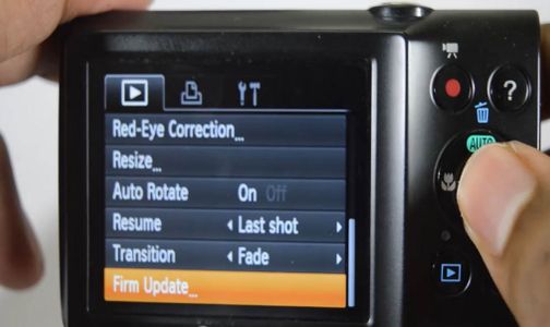

Step 4: Installing the Firmware
After downloading the file , unzip it and extract the file to the SD card.
Eject the SD Card and put it back to the camera, and then open the camera in playback mode.
Turn on the camera on in playback mode, and hit menu button.
Go down and hit the update firmware option .
It will ask for a confirmation .
Click OK and your firmware will be updated.
Once update press shutter to get into the camera mode and enjoy the new camera features.
