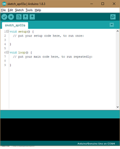

Required software: Arduino IDE
To work with Arduino and the Sparkfun CAN bus shield you will need to download some software, the most important piece of software is the Arduino programming interface, referred to as the Arduino IDE which can be downloaded from the link in the software sources section.

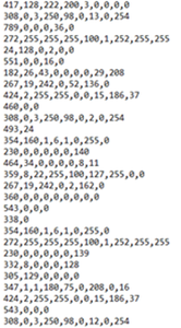

With the Arduino connected to the computer and serial monitor open, you should see the repeating message: “No data”, this means the Arduino is connected to the computer correctly, and data is coming in, at this point connect to the CAN bus network, you should instantly see data coming in, if you do not, but nothing else happens such as a check engine light, check your connection. • If glitching does not occur but you do not receive any data, and you have connected via the pins on the shield, you may have the CAN bus lines connected the wrong way around or to the wrong wires. • If no glitching occurs and you have no data, check that you did not accidentally disconnect the Arduino from the computer by seeing if the no data message is still coming in or by closing the serial monitor window and opening it again. If you have no success and are connected via the CAN H and L pins rather than the diagnostics port, please try the process on the diagnostics port to determine if the hardware setup is at fault.

When making a diagnostic request for data, the query consists of 4 variable bytes.
ID, the first byte is ID which is always 2015 ( A data request ).
- Ch1, the second is the query length (Always 2 bytes for SAE Standard)
- Ch2, the third byte is the mode (Wikipedia, 2017).
- Ch3, the fourth is the data requested, these are called Parameter ID’s (PIDS)[1]
- Ch4 – ch8 are unused in a request.
You send the following frame to get back diagnostics data:
The PID for throttle position is 17, as such we send the following:
< Request 2015, query length 2, Mode 1 Live data, PID 17,0,0,0,0,0 >
The reply is: < requested 17, Throttle = 0 to 255, 0,0,0,0> or <2024, 3,65,17, 0,0,0,0,0>
The unused last five channels may or may not all be used to represent the requested PID depending on its precision requirements.
Most are of a range to be adequately represented when divided into values between 0 and 255. However, some may require more granularity such as RPM.In order to send data into the network, you will need to use the code from the demonstration code entitled “Demo 2”, you will need to changes the values in the bottom of the code for the ID which looks like this: “message.id = 0;” to the Data request ID of 2015. You will also need to change the code for each channel from this: message.data[0] = 0; to the respective value as explained above.

5.1 Analysis method: Serial Monitor
For retrieving the raw data from CAN , there are a number of methods and tools to assist in the process. The initial method for interpreting what each frame on the network represents is to do the following steps:
- log a few seconds of all raw data coming through the network and save this in a document.
- One by one pick a frame from the list and change the code to filter all but that frame.
- Trigger events in the vehicle and note changes.
- Remove that frame from the list
- Repeat from step 2.
This is a long process but will allow you to easily correlate the data on a CAN network to the frame you are monitoring. In order to set a filter in the Arduino code to only show one frame though serial monitor, change the value -1 to the ID you are working on and != to ==, for the line “if(message.id != -1) {“ in the code.
e.g: “if(message.id != -1) {“ to “if(message.id == 520) {“
