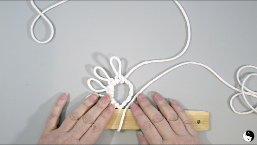

With the working end (attached to the spool) form a loop approximately 3 cm; that’s the same width as a paint stick.
Step 5:
Pinch the loop tight with your left hand, bring the cord around to the back and push through the centre. Bring the loop down and around the first loop formed to capture it.
Step 6:

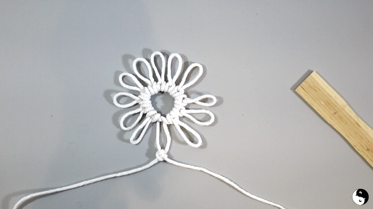

Tighten the knot. The first picture above is how your first loop should look.
In case you’re having trouble keeping your loops consistent, to use a paint stick to form them around.
Continue around the centre forming loops and capturing them in the same manner until you have 11 loops.
When back to the beginning, form a double knot to bring the two ends together. This makes the 12th loop. Every time you finish a row, you will knot the two ends together. Make sure that the tail ends up on the left side – without twisting. If it does, remove and re-knot again.

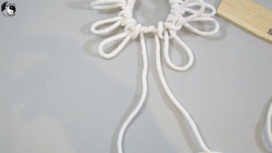

Step 7: Second Row
It’s helpful to secure your first row onto a thread holder like above. My thread isn’t quite wide enough to hold it tight so I added a velcro strap and the cord just pops right over. Now it's easier to rotate the work as you progress.
Cut a piece of cardboard 6mm or 2 3/8″ wide. Slip it under the first working loop.
Step 8:
Pass the spool underneath, through the loop from left to right.
Step 9:
Pull the cord. Watch the video at the beginning to see my tips in action for keeping these loops consistent.
Secure the knot and remove the cardboard.
It may take some practice, but try to be consistent with the loops! Mine weren’t perfect because the camera obscures my view :).
Step 10:
Continue until back to the beginning and double knot the ends once again using the tail end.
As you tighten each the knot, don’t forget, the tail end should end up on the left side. If not, the loop will twist so try again.
The first pic is how your work should look after two rows.
