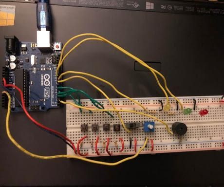

To start off, I will briefly explain how I made it. It uses the arduinoFFT library. FFT stands for Fast Fourier Transform, and it is the type of calculation needed for the sound sensor's analog input to be interpreted as a digital frequency by the Arduino. Without this library, the sound sensor can only figure out how loud a sound is, which isn't particularly relevant to its use here. The way I used the library here is, I first strummed my guitar strings over and over again to see which dominant frequency it recorded (this can be checked by looking at the serial monitor of my final code). Once I noticed a consistent number for each string, I set a range of +/- 4 Hz for each string since the sensor may not be accurate 100% of the time. I then ran into the problem of some strings' dominant frequencies being quite close to each other, and my solution to that was to implement a button. This button, when pressed, changes which string is being tuned. In order for the user to know which string they're on, I added LEDs, with one more LED turning on each time you press the button (with 0 LEDs being the high E string). For reference, the default is one LED, and it denotes that the low E is being tuned. Once I had that all sorted, the code was good to go! Please note that you may have to alter the frequency ranges for each string based on the acoustics of your room and the sound sensor's placement.

In terms of the guitar tuner, there is :
The pushbutton going to digital pin 2
The LED signifying the Low E is being tuned on digital pin 3
The A LED going to pin 4
The D LED going to pin 5
The G LED going to pin 6
The B LED going to pin 7
The LED that lights up when you are in tune going to pin 8
In case the picture does not give a clear idea, I have attached the TinkerCAD wiring diagram of my circuit.
