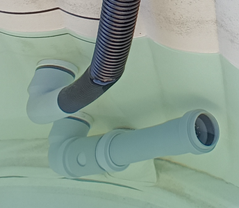

Step 3: The Underwater Vacuum Cleaner
We will now use the filter pump as an underwater vacuum cleaner.
Remember, I offered to buy some more stuff from the sanitary dept:
1. A second 90-degree DN50-DN40 pipe elbow
2. A second DN50-DN40 rubber-reducing ring
3. A DN40 pipe cap
4. A DN 40 rubber-fitted sleeve*
5. A piece of DN50 pipe (8 cm is enough)
   and a scourer.
Force-pull the stainless-steel scourer (which will serve us as a dirt filter) into the piece of DN50 pipe. (like #11 of the BOM pictures)
Use the rubber-fitted sleeve as a joint between the pipe elbow and the dn50 pipe.
Screw the filter away and mount the rubber sleeve and the reductive elbow on the water inlet like you did on the outlet for the solar heater. Remember: by doing that, hold firmly the elbow since it is not screwed and only holds on the rubber to the outlet thread.
By the way: that stainless steel filter is almost as efficient as the expensive Intex paper filter and must never be replaced.
*originally I have foreseen an adjustable bypass on that sleve, which proved to be unnecessary, so dont be surprised if my picture has that bypass tinkered to. You just need a stock sleeve.

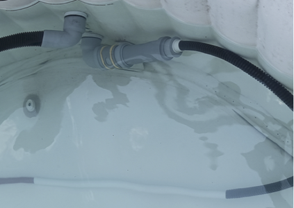

Step 4: Making the Vacuum Cleaner Broom
Drill a hole in the DN40 cap and find a way to glue/fit the corrugated flexible electric sheath and some watering hose in that hole. This will be our vacuum cleaner broom.
Take care that the vacuum cleaner broom is filled with water before starting the filter pump, else the pump will suck air and disconnect.

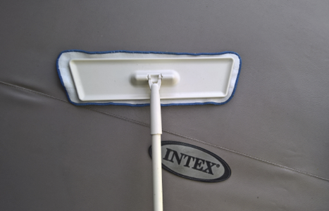

Step 7: Clean Glitchy Sides
If the sides and the bottom of your SPA get glitchy, you may need an additional step:
Clean the bottom and sides with a plain household Ikea mop (yes, under water!)
Remove the dirt and the glitch coating from the walls and the bottom with the mop (you will be amazed how much dirt comes out!) Another part of the dirt ends up suspended in the water.
Repeat the step 6. (Whirl and vacuum-clean, then whirl again and wait for 20 minutes for the dirt to coalesce to the centre. )
All the dirt will aggregate at the bottom in form of lose flocks and can easily be vacuum-cleaned again.
In less than a minute vacuuming, all that dirt ends up in the scourer and your pool is spotless!

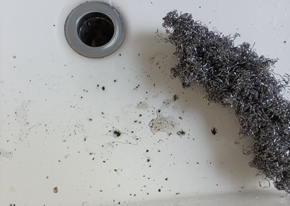

Step 8: Cleaning the Scourer Filter
You may then unplug the DN40 tube containing the scourer, put your Intex filter back and continue filtering and heating…
Then pull the scourer out of the pipe and rinse it in your bath sink.
That was a very light cleaning, you may get a LOT of brown dirt and particles!
With a cleaning of this type every three days, and a little bromine/ plus a tiny bit of bleach, my water is still spotless after two months!
