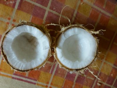

Step 3: Break Open the Coconut
- The coconut here is husked few days earlier and stored for latter use. This also contains water which you can collect and drink. It may not be as tastier as tender coconut water, still it tastes good.
- Remove the husk covering the eyes of the coconut
- Hold the coconut in your palm so that the eyes are on the side
- Tap lightly around the nut at the center with back side of the machete. This will crack open the nut.
- Collect the water in a container and drink. Use the coconut meat in your cooking
