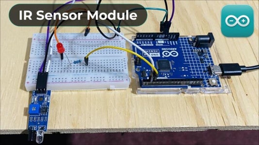

Step 4: 2nd Type of IR Sensor
2nd sensor type
Ok, let’s see how to use another type of IR sensor with Arduino.
The PIN structure of this sensor
So, step by step we will learn how to connect this sensor with Arduino. For that, the required components are given below.
  1. Arduino Nano board
  2. IR sensor
  3. LED bulb
  4. Breadboard
  5. Jumper Wires
Disclosure: These Amazon links are Affiliate links. As an Amazon Associate, I earn from qualifying purchases.
Step 1
Firstly, identify these components.
Step 2
Attach the components to your breadboard.
Step 3
Connect these components to your Arduino board using the jumper wires. Do it according to the circuit diagram below.
Connect the sensor OUT pin to the Arduino board D2 pin and connect the LED anode pin to the D3 pin.
Step 4
Now, copy and paste the following program to the Arduino IDE.
  1. The complete program of this project – Download
void setup() {
pinMode(2, INPUT);//define arduino pin
pinMode(3, OUTPUT);//define arduino pin
Serial.begin(9600);//enable serial monitor
void loop() {
bool value = digitalRead(2);//get value and save it boolean veriable
if (value == 1) { //check condition
Serial.println("ON");//print serial monitor ON
digitalWrite(3,HIGH);//LED on
} else {
Serial.println("OFF");//print serial monitor OFF
digitalWrite(3,LOW);//LED off
This code sets 2 pins as input pins and 3 pins as output pins.
void setup() {
Takes the digital value and puts it into the Boolean variable. The Boolean variable is named ‘value’.
This value is checked using the IF condition. When the digital value is 1, the LED bulb turns on and when the digital value is 0, the LED bulb turns off.
} else {
Step 5
Now, select the board and port. After, click the upload button.
So, now you can test this sensor. The full video guide is given below.
