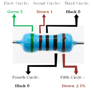

Step 2: Look at a Picture
Before we move on, let’s take a look of the picture. What can you see from this picture?Can you read the resistance value by yourselves? I guess this is head-aching task for you who never know any electronic knowledge. From the figure above, i can read that resistance value is 4.7kΩ, tolerance ±1%. Can you read the resistance value by yourselves? I guess this is head-aching task for you who never know any electronic knowledge. From the figure above, i can read that resistance value is 4.7kΩ, tolerance ±1%.

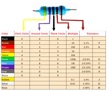

Step 3: Learn How to Read Color Circles
Firstly, let’s learn how to read color circles.
Four-color resistance: The first circle and second circle in four-color resistance relatively represent the former two numbers of resistance value, the third circle stands for magnification, and the fourth for tolerance. The key point to identify it quickly depends on the third color circle which limits the resistance value to a scale. For example, several decimal point K or tens K. You can place the number of the first and second circle showed into this format so that you can read the resistance value very quickly. Five-color Resistance:The former three color circle stand for valid numbers, the fourth circle for the Nth power of 10, and the fifth circle for tolerance. Six-color Resistance: Readings of the former five circles are the same with five-color resistance, but the last circle stands for temperature index of resistance.
Step 4: A Case for You
Now, you might know a little bit about how to read color circles but still not fully understand. Let me show you a case of four-color resistance and learn how to read these color circles better:
1. Try to recite the number of each color represents in the former two circles. As for five-color or six-color resistance, you can recite the former three circle values. You can recite like this: brown 1, red 2, orange 3, yellow 4, green 5, blue 6, purple 7, grey 8, white 9, black 0. Read it together and repeat it again and again so that you can remember these values.
2. Try to remember the resistance scale of the third color circle.As for five-color or six-color resistance, you shall remember the resistance scale of the fourth circle. This is the key point to identify resistance value quickly. The following is the actual scale of each color: Golden:several decimal point Ω Black:Tens Ω Brown:Hundreds Ω Red:several decimal point kΩ Orange:Tens kΩ Yellow:Hundreds kΩ Green:several decimal point MΩ Blue:Tens MΩ According the magnitude , we can divide these colors into 3 levels for easier remembrance: Ω level: golden, black, brown; KΩ level: red, orange, yellow; MΩ: green, blue. 3. When the second circle is black, the third circle stands for an integer. As for five-color or six-color resistance, it is the third or the fourth color circle relatively. The integer can be several, tens or hundreds KΩ. This is a special case for reading. You have to pay more attention to it. For example, if the third circle is red, then the resistance value is integer tens KΩ. 4. The fourth color circle represent tolerance. As for five-color or six-color resistance, it is the fifth color circle. Here is the tolerance value of each color: Golden: 5%; Silver:10%; None:20%.

Step 6: An Example
Now read the resistance value of this picture.(Answer: Resistance Value=510X1=510Ω.)
