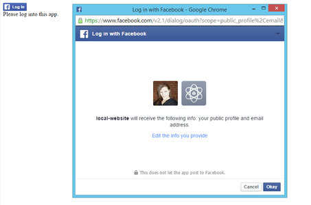

Now if you save this page as index.html and open it in a browser you should see the Facebook Login button. You can use the code provided by facebook at the link listed above or you can used the codepen code that I have altered to make it a bit shorter for explanation.
Step 3: Testing
Log In and look at the console output. You’ll now see some basic info including id, email, first_name, gender, last_name, link, locale, name, timezone, updated_time, verified
That is all there is to it. Of course, there are many more scopes you can use which allow you to collect more data currently this script has a scope of public_profile and email, features and API calls you can play with to create your desired app just explore the Facebook documentation to discover all these features.
