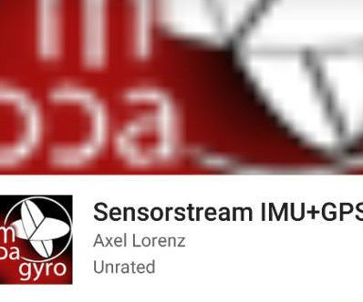

This tutorial covers how to import and process data recorded with the 'Sensorsteam IMU+GPS' application developed by Axel Lorenz. If you need help with recording and saving data with this app, click here to read my previous post.
