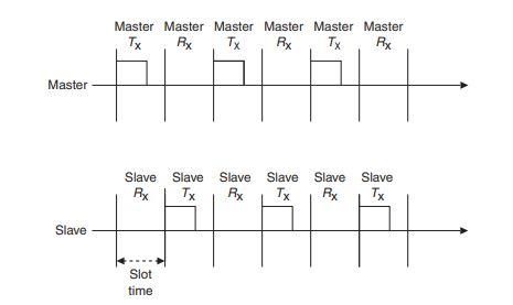

Following Figure describes the transmission of one-slot-type packet between a master and a slave. The master transmits a packet in a slot and the slave sends the data to master in next time slot. The time slots need synchronization between the master and the slave. Since our device is a micro receiver, it will need comparatively more power to finish its task.
