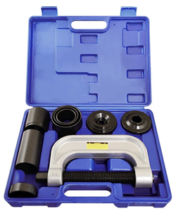

Step 3: Remove Old Ball Joint
Remove the locking ring that secures the ball joint rubber boot. Then remove the locking ring that secures the ball joint into the control arm. With the locking rings removed, use a ball joint pretty kit to remove the ball joint from the control arm.

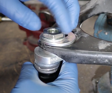

Step 4: Install Adjustable Ball Joint
Disassemble the adjustable ball joint by removing the nut and camber gauge. Instill the ball joint into the control arm from the bottom, aligning the groove of the balljoint and the groove of the control arm. Place the camber gauge on top of the control arm and secure it all but install the nut on the ball joints thread.
Step 5: Set Camber
You can now slide the ball joint forward and backward on the camber gauge, I slide mine to the max positive camber setting to correct my camber problem. Then torque the balljoints top nut to the specified torque.
