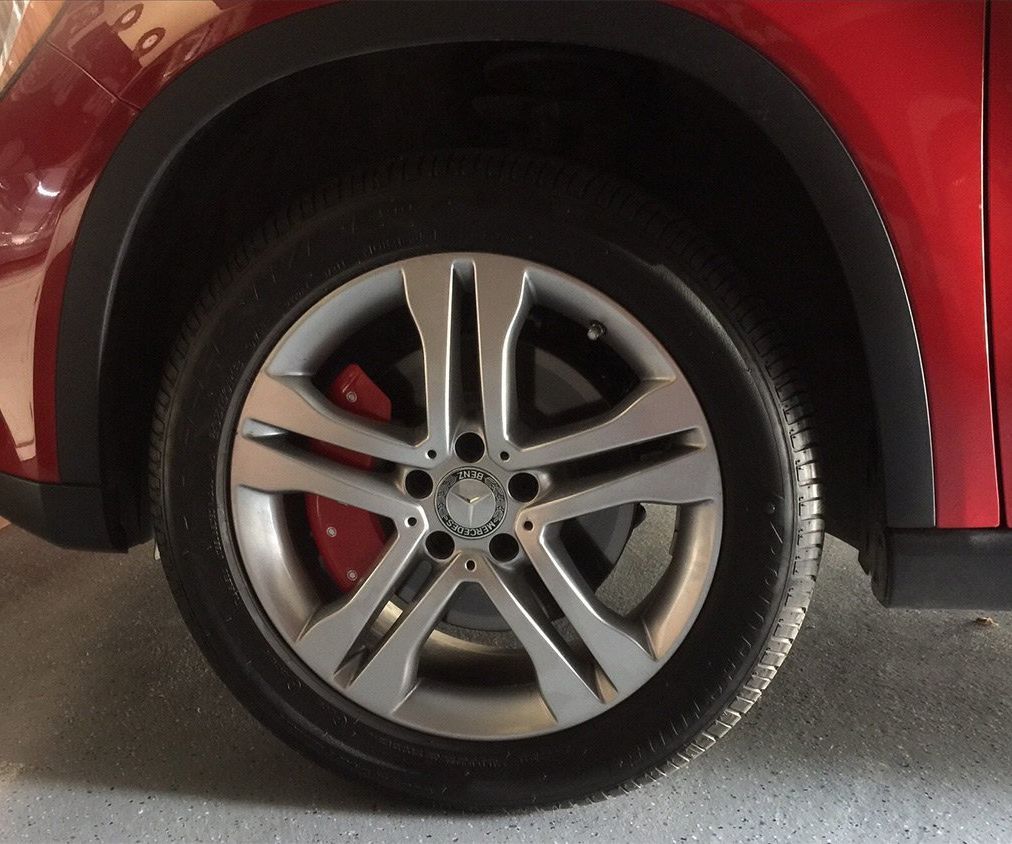

Step 3: Getting Started
You’ll need a jack, a jack stand, a siphon, a lug wrench, and a c-clamp.
First jack up your vehicle. I always recommend a jack stand for safety.
Take a wheel off. You’ll need the wheel off to access your hub, rotor, and calipers.
Using a siphon, remove about a third of your brake fluid.
Using your c-clamp, compress the brake caliper and loosed the caliper’s slider bolts.
Now you’ll be able to slide the caliper off of the disc.
