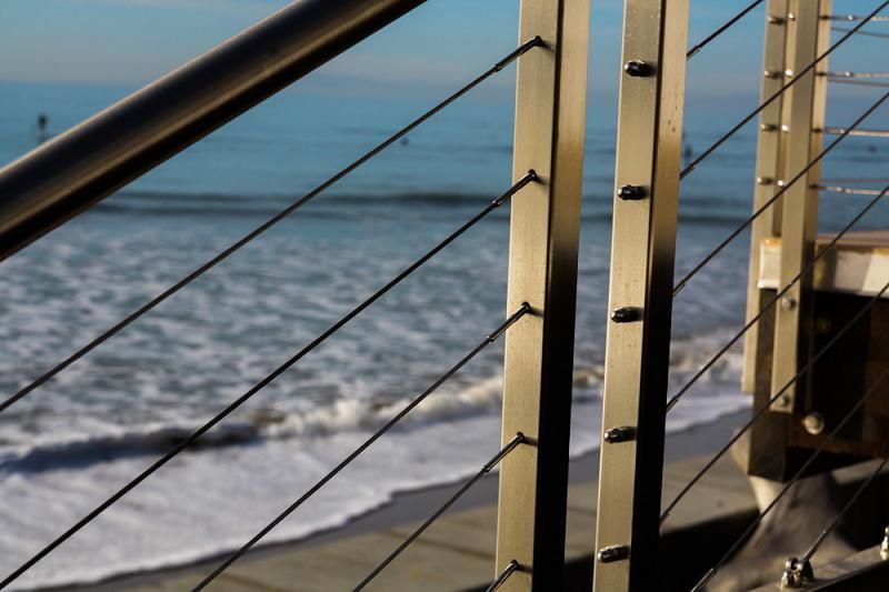

Introduction: How to Install Cable Railing Fittings
This quick video is an AGS Stainless tutorial demonstrating how easy it is to install cable-end fittings on your new stainless steel cable railing. Brandon will cover the steps to accurately cut and crimp fittings on your 316 stainless cable for proper tensioning. Note Brandon's Pro Tip in the video: Thread the jam and acorn nuts on the opposite end, ensuring to bottom out the acorn nut to easily and accurately help with measuring the required cable length, but giving you a bit of margin for error. Whether you are a homeowner or professional, our Clearview® Cable Railing System is made for easy DIY installation.
