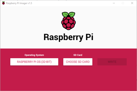

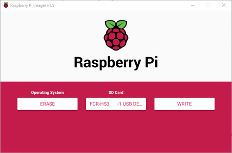

- When you run Raspberry Pi Imager you are presented with two options: Choose OS and Choose SD Card.

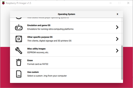

- Scroll down to the bottom of the list and click on the Erase option.
- Now click the "Choose SD Card" Option and select the target SD Card. Note that any data still on this SD card will be erased forever, and you should ensure that you have a backup of any files you would like to keep.

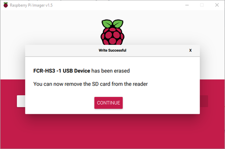

- With the SD Card Selected the "Write" option becomes available. Click Write and wait for the process to complete. Once the process is complete, a notification window will open letting you know that it's now ok to remove the SD card from the reader. Remove the SD Card and reinsert it into the reader to make it available again.

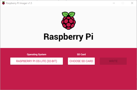

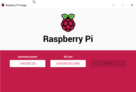

- Click the "Choose OS" button, and select one of the available operating systems. For the purpose of this tutorial we will be using the top option, Raspberry Pi OS Lite (32-Bit). This version of Raspberry Pi OS does not include a preinstalled-GUI, this means that there is no desktop environment wasting space and resources when it's not needed.
- Now select the SD card we just formatted in the previous step.

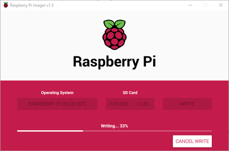

- The "Write" option will become available. Click "Write" to begin burning the image to the SD card.
- It can take anywhere from a few minutes to upwards of half an hour for the process to complete depending on the quality and speed of the SD card, card reader, and computer.
- Note: Be patient and wait for this process to complete. If you remove the SD card, unplug the card reader, or shut down the computer at any point during this process, the card will become bricked and unusable.

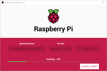

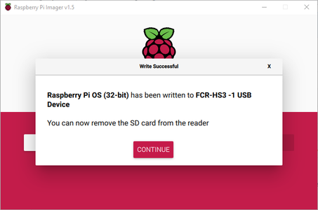

- Once Raspberry Pi Imager has finished writing the files to the SD card, it will verify that the image on the SD card is identical to the image file used to burn the image. This usually takes less than a minute but could take longer.
- When the verification process is complete, a notification window will open letting you know that the write was successful and that it's now safe to remove the SD card.
- If you're going to run this install with a monitor, you are good to go.
